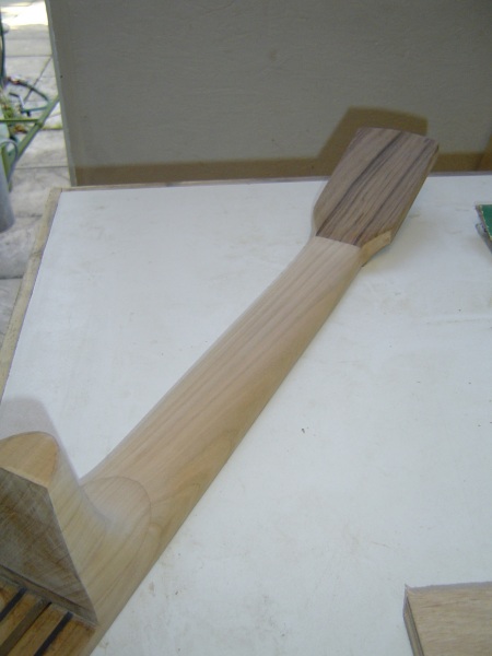

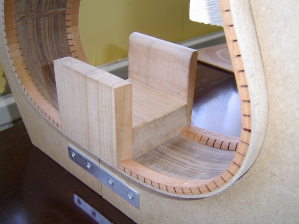

Cherry makes a great neck and neck/tailblocks. I don't know the particular species your talking about as we don't have that one over here, but I know it is becoming popular.
I'm currently building an OM with a cherry neck and also head and tailblock. Russell Rose another of the UK builders uses Cherry a lot as well.

I like your laminated block Colin, kinda what I had in mind.
